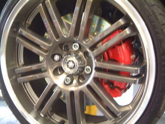

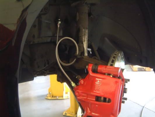

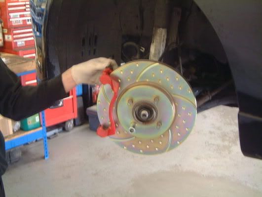

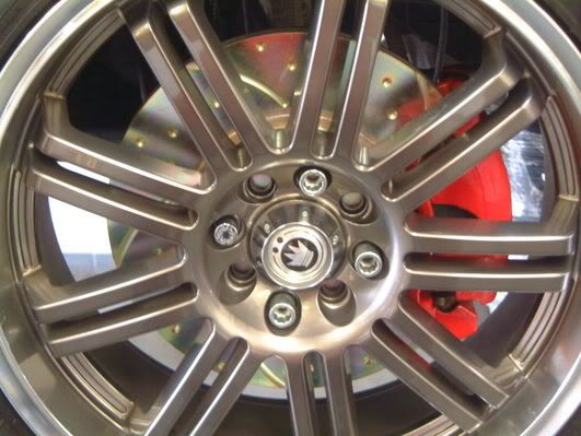

    Front Install is now complete.Here is a full Detailed Spec of What you need to do.
    This Setup is Ideal for All Mk6's & Mk4/5's.The difference is incredible,I would just like to Thank Graham (Nugget) on Carrying out this conversion for me.
    Clamp Brake Hose
    Drill Mounting Holes to 12mm
    Attach Carrier with two bolts using 13mm Spanner Torque Carriers
    Insert Pads and attach Carrier useing Threadlock
    Attach Braided Hose useing a 11mm & 17mm Spanner
    Close up of Body Mounted Brake Connection
    Job Done
    Wheels Back On

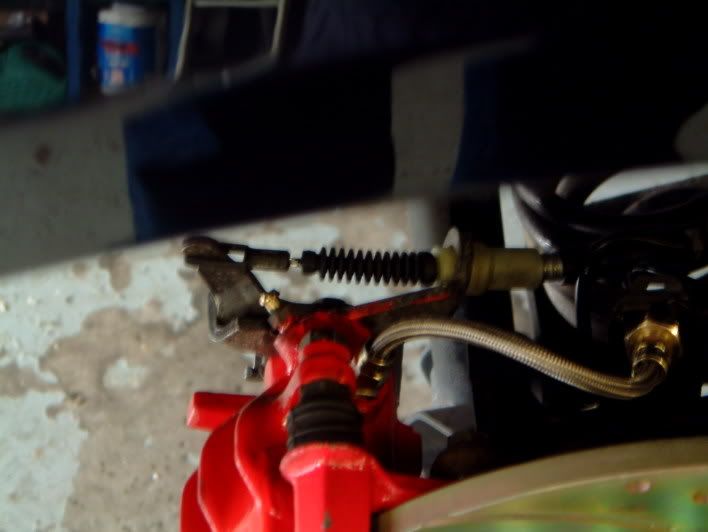

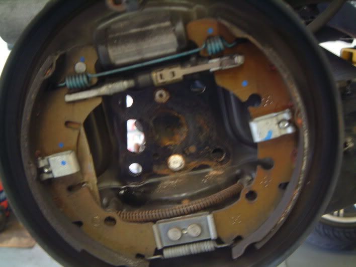

    Parts Needed to carry out this conversion are as follows.

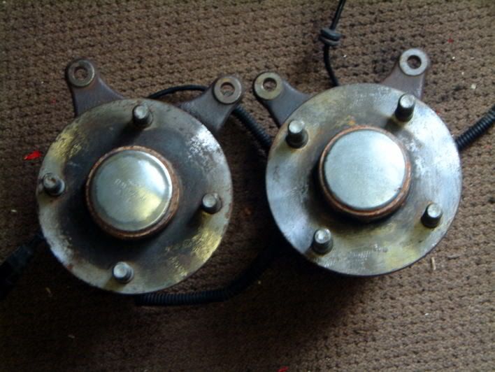

    ST170 280mm Rear Discs.RS focus 0r ST170 Calipers & Carriers.Pads.ST170 Rear hubs.4x Braided Hoses.ST150 HandBrake Cable.ST170 BracketB/Hose
    ST170 Rear Hubs
    2x 150mm Braided Hoses.2x 300mm Braided Hoses
    ST150 Handbrake Cable Part No 1211024

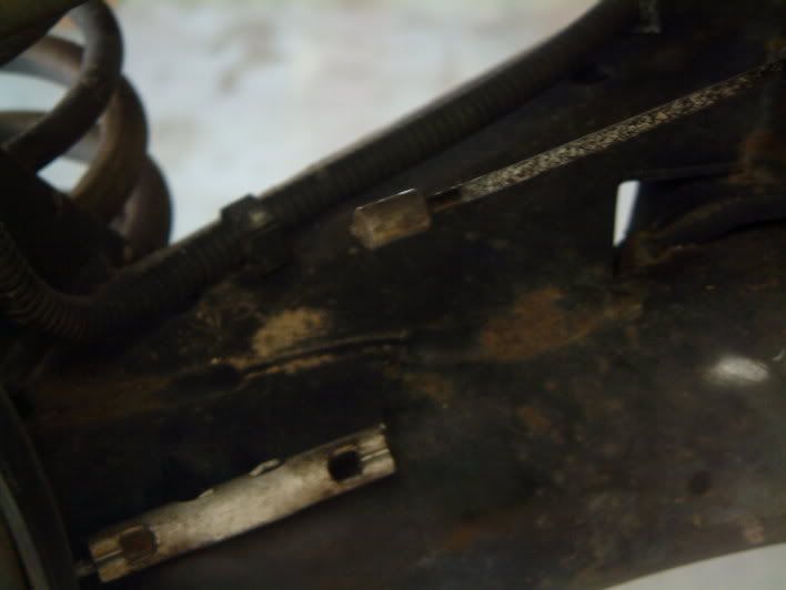

    Lift of Trim around handbrake Leverand slacken off Cable using 10mm Spanner
    Clamp Brake Hoses

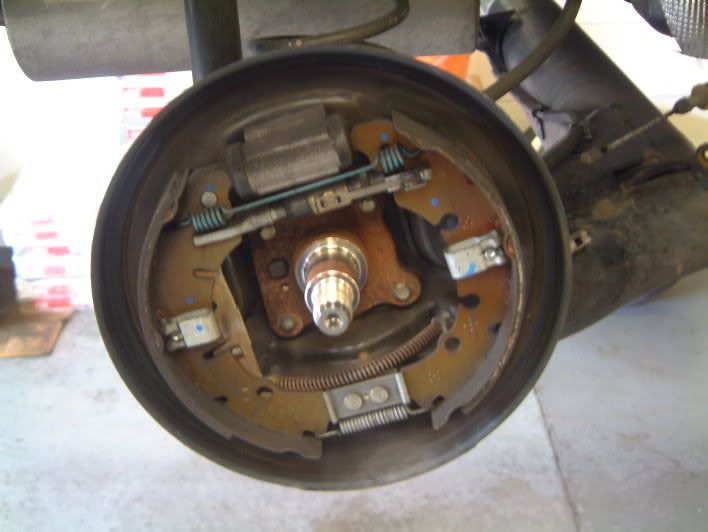

    Disconnect Cable from Drums
    Undo Two 8mm bolts and remove ABS Sensor (if Fitted)
    Remove Hub Nut Coverand using a 30mm socket undo the Nut and take drum off
    Undo Brake pipes at rear of Drum using 11mm Spanner

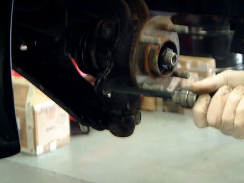

    Use a 17mm socket on 4 nuts on rear of Stub axle and remove

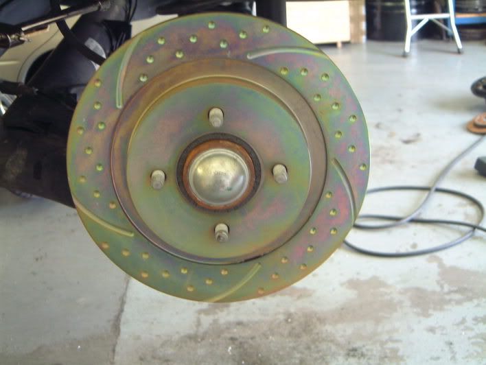

    Drill out the two Rivets which hold the Splash gaurd in place

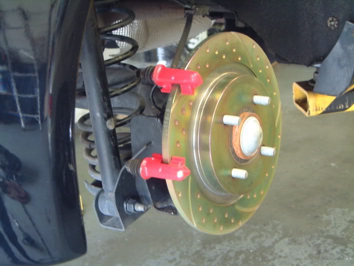

    Mount ST170 Hubs using 13mm socket applyThreadlock to each nut 4 in total
    and mount disc.attach the ST170 Hose bracket at the same time

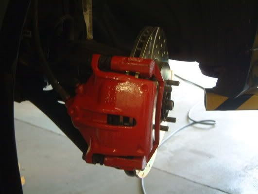

    Attach Carrier

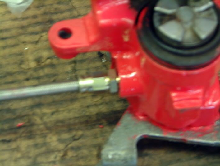

    Connect the 150mm hoses to the calipers
    Fit Pads and put Caliper on using the two 13mm bolts

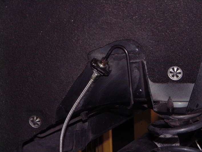

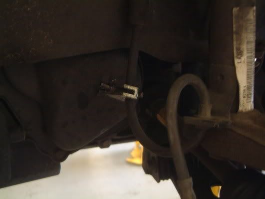

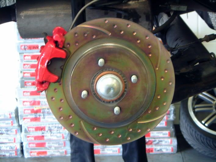

    Disconnect Brake hose from Body.and attach 300mm Braided Hose
    Secure Braided hose in new Bracket

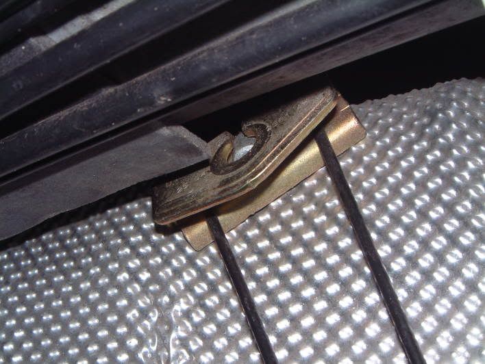

    Take old hanbrake off car and pull out Black gromet rom linkage.The heat sheild will haveto by pulled down to access this part.
    clip new Handbrake cable back up behind heatshield and attach to Calipers
    Bleed Brakes 1st then Adjust Hanbrake cable up and replave trim around Handbrake
    Job Done :grin:
